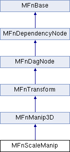

Inheritance diagram for MFnScaleManip:Public Member Functions | |
