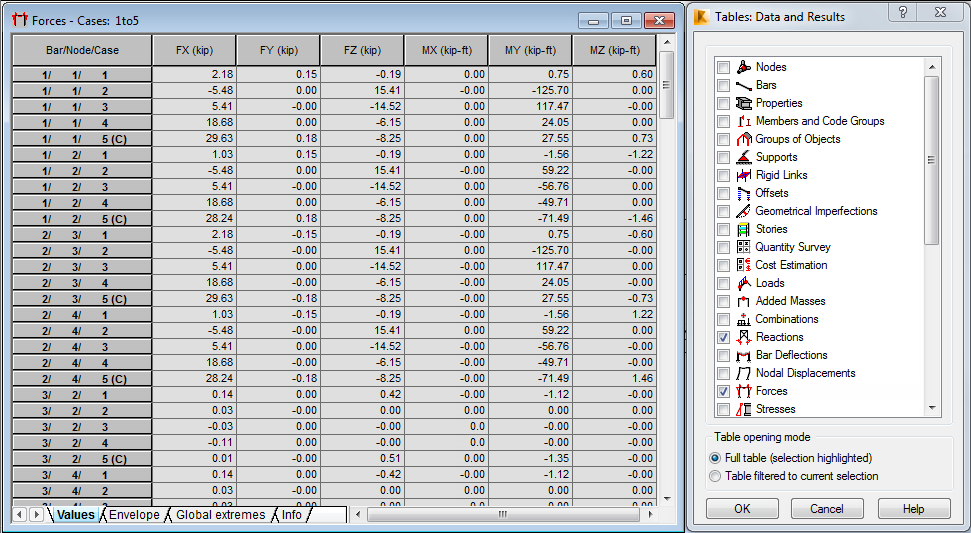

  3. Click View Tables.
    Alternatively, right-click in the View-Cases window, and then click Tables from the context menu.
    The Tables: Data and Results dialog opens.
  4. Select Forces, and then click OK.
    Alternatively, click (Forces - Table) in the Structure Model toolbar on the right side of the program.
    The Forces table opens and displays information about internal forces. Tabs are available at the bottom of the table, allowing you to visualize information on Values, Envelope, and Global Extremes data.

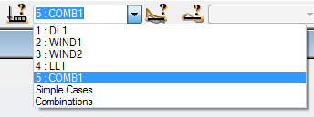

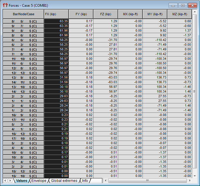

  5. In the Cases Selection box of the Selection toolbar, expand the Cases drop-down menu and select 5: COMB1.
    The table updates and presents the results for the COMB1 case.
  6. In the Forces table, double-click the FX column header to sort the forces from the maximum to the minimum values.

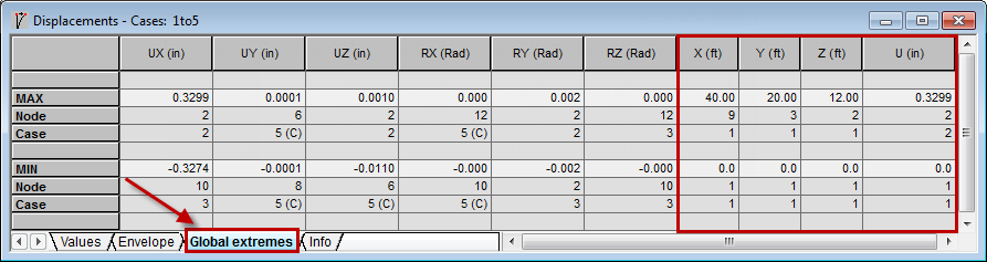

  8. Select Nodal Displacements, and then click OK.
    Alternatively, click (Displacements) in the Structure Model toolbar on the right side of the program.
  9. Right-click in the Displacements table, and then click Table Columns from the context menu.
  10. In the Nodal value selection dialog:
    • Go to the Displacement tab, and select U - total displacements,
    • Go to the General tab, and then select Coordinates from the Element data selection group.
  11. Click OK.
    Four new columns are added to the Displacements table (as shown in the image below).
  12. In the Displacements table, go to the Global extremes tab located at the bottom of the table.
