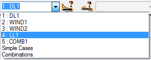

  4. In the Cases Selection box of the Selection toolbar, expand the Cases drop-down menu and select 4: LL1 as shown below:

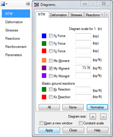

  5. Go to the NTM tab of the Diagrams dialog, select MY Moment, and click Normalize.
    Note: Click Normalize to scale the values of the selected type of diagram automatically.

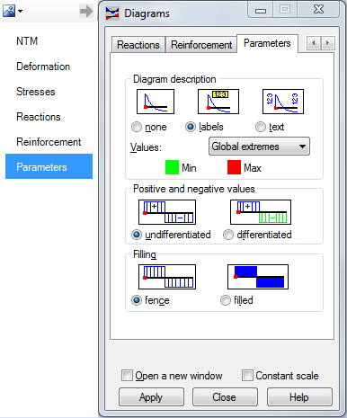

  6. To display numerical values of internal forces, go to the Parameters tab.
    Tip: You can access the Parameters tab without having to scroll through the tabs. Place the mouse cursor over the arrow near the top left corner of the dialog to display the list of tabs.
  7. In the Parameters tab, set the Diagram description to labels, and then select Global extremes from the Values drop-down menu .
  8. Click Apply.

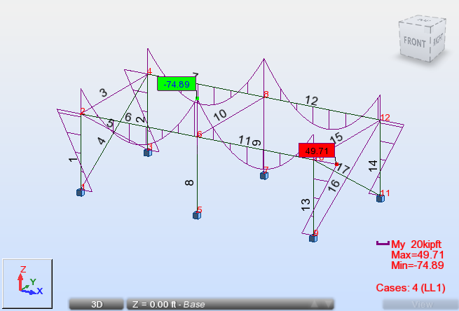

  9. The view displays the bending moment diagrams for all beams as shown below.
