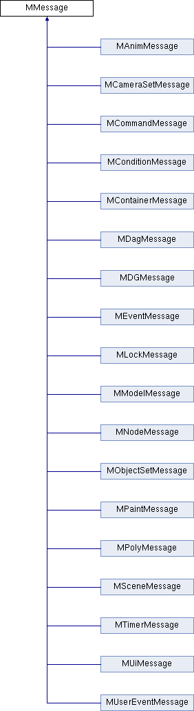

Inheritance diagram for MMessage:Public Types | |
