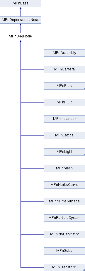

Inheritance diagram for MFnDagNode:Public Types | |
