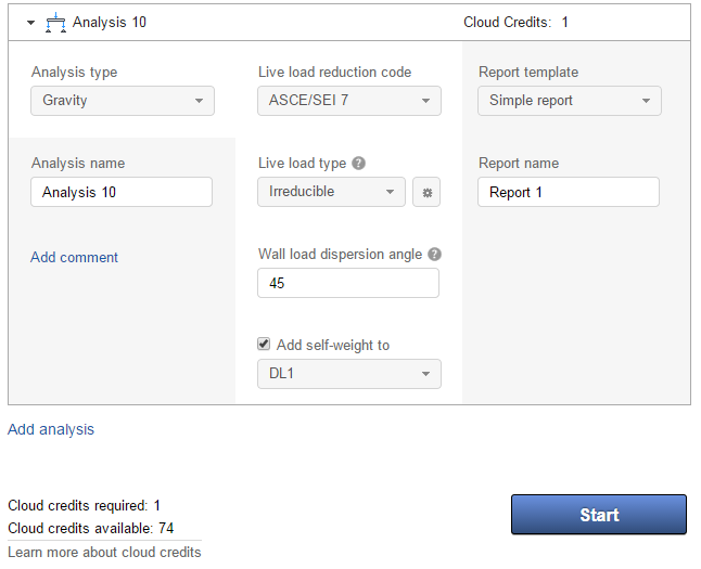

  1. On the Projects tab, select a project.
  2. On the project page, select a model to perform the analysis for.
  3. Click New Analysis.
    The New Analysis page opens where you can define parameters of the analysis. By default, it displays the type and parameters of the analysis performed previously.
  4. Define analysis parameters.
    To learn more about definition of parameters, see Performing the Analysis.
  5. Click Start.
