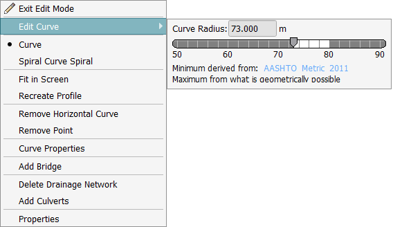

To select the radius from a range of values
  1. Click Edit.
  2. Select the road.
  3. Right-click the curve you want to change. Highlight Edit Curve.
  4. Change the radius in either of the following ways:
    • Drag the slider to the desired radius.
    • Enter a value in the Curve Radius cell.
    Note: The radius values that are geometrically possible for the curve are shown on the continuum. If a value that is outside the solvable range is entered, a warning message is displayed.
