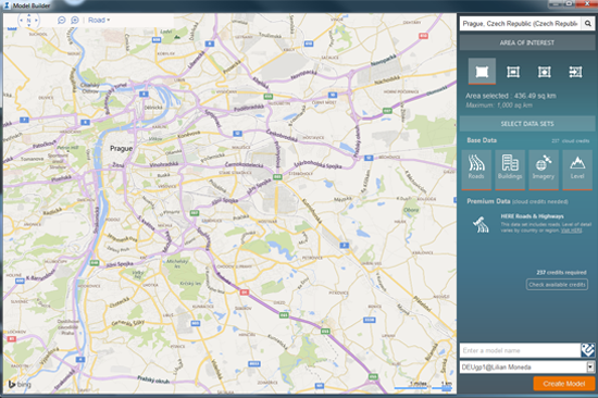

  1. From InfraWorks 360 Home, click to expand a horizontal menu and click Model Builder.
    Note: You can choose New to create a model manually, or choose Open to select a SQLite model file to open.
  2. You can either select an area of interest on the map, or import a polygonal area of interest from a SHP file.
    Note: The Model Builder supports model areas up to 200 square kilometres, or lengths up to 200 kilometres in latitude or longitude.

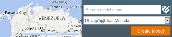

  3. Enter a name for the model and select the InfraWorks 360 group for the new model.
    Note: Optionally, click to enter a description for the model.
  4. Click Create Model.
    InfraWorks 360 sends an email notification to the email address associated with your Autodesk 360 account when Model Builder has finished loading the model.
