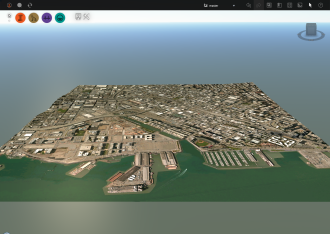

Terrain and Aerial Imagery (Orthography)
Aerial imagery is draped on the terrain.

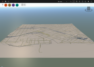

Terrain and Transportation Data (Roads and Railways)
Roads and railways are draped on the terrain.
  • You can sketch or import roads and railways.
  • Imported roads and railways are represented in InfraWorks 360 as planning roads and railways, which only support basic geometry. This is also true for models that were created by the Model Builder.

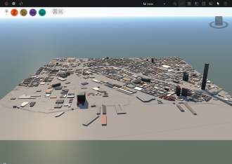

Terrain and Building Data
Buildings are draped on the terrain.
  • You can sketch or import buildings.
  • Configure imported buildings data to specify desired settings such as roof height, roof material, building facade and base colour.
