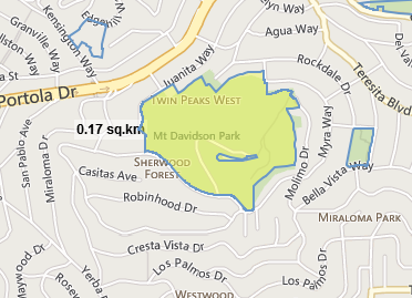

- Select the desired polygonal area of interest on the map.
Note: Your SHP file might include multiple polygonal areas. Before you select an area of interest, hover over each polygonal area to see the size of the area of interest.

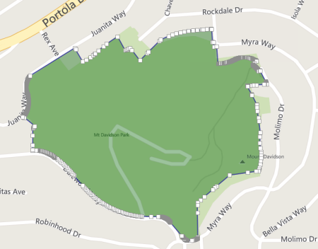

- Select the area of interest again to display grips for individual vertexes, which you can drag to modify the area of interest.
- When you're finished adjusting your area of interest, enter a model name and group, then click Create Model.
