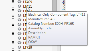

Note: Hover over a device node to display more information about the device, such as catalog and description.
