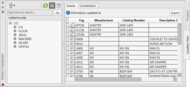

Details Pane
Displays component details.

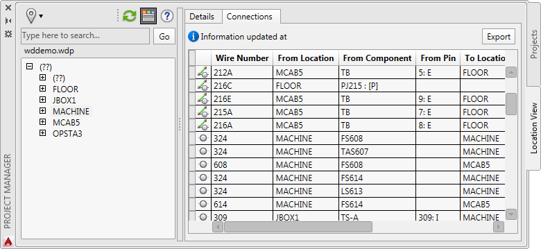

Connections Pane
Displays wiring and connection information

Available Fields - Details Pane
  • Tag. The tag value on the device.
  • Manufacturer. The MFG value on the device.
  • Catalog Number. The CAT value on the device.
  • Description 1. The DESC1 value on the device.
  • Terminal Strip. The TAGSTRIP value on a terminal.
  • Item Number. The ITEM value on the device.
  • Assembly Code. The ASSYCODE value on the device.
  • Category. The catalog table for the device based on the WDBLKNAM value, component type, or block name.
  • Rating 1. The RATING1 value on the device.
  • Rating 2. The RATING2 value on the device.
  • Terminal Number. The terminal number for a single level terminal, list of terminal numbers for a multi-level terminal, or wire number for terminals that take on the wire number.
  • Description 2. The DESC2 value on the device.
  • Description 3. The DESC3 value on the device.
  • Installation. The INST value on the device.
  • Location. The LOC value on the device.
Available Fields - Connections Pane
Each row in the grid can include two connected components, referred to as the From and To components. Whether a component is considered the From or the To component is based on the wire sequence for the wire network. The wire sequence can be defined specifically or can default to the Tag/Wire Number/Wire Sequence Order defined on the Drawing Format tab of the Drawing Properties dialog box.
  • Wire Number. The wire number assigned to the wire.
  • Wire Id. The identifier assigned to the wire in Inventor.
  • From Installation. The INST value on the From device.
  • From Location. The LOC value on the From device.
  • From Component. The tag value on the From device.
  • From Pin. The pin value on the From device the wire is connected to.
  • To Installation. The INST value on the To device.
  • To Location. The LOC value on the To device.
  • To Component. The tag value on the To device.
  • To Pin. The pin value on the To device the wire is connected to.
  • Cable Installation. The INST value on the cable marker on the wire.
  • Cable Location. The LOC value on the cable marker on the wire.
  • Wire Type. The wire type for the wire as defined in the Create/Edit Wire Type dialog box.
  • Wire Color. The wire color for the wire as defined in the Create/Edit Wire Type dialog box.
  • Wire Gauge. The wire size for the wire as defined in the Create/Edit Wire Type dialog box.
  • Cable. The tag value on the cable marker on the wire.
  • Wire Length. The wire length as defined in Inventor.
