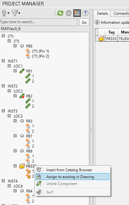

  1. Click Project tabProject Tools panelManager. Find
  2. In the Project Manager, click the Location View tab.
  3. In the Location View tab, right-click the Inventor part and click Assign to Existing in Drawing .
  4. In the active drawing, select the electrical component you want to link with the Inventor part. The component tree view is refreshed after you have created the component linking to show the linked component.
