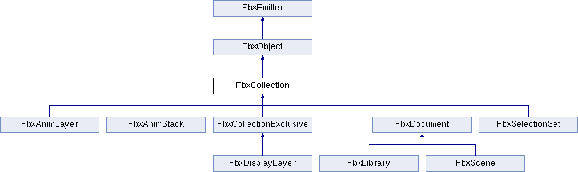

+ Inheritance diagram for FbxCollection:
