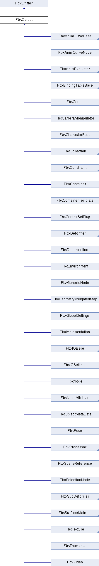

+ Inheritance diagram for FbxObject:
Public Types
typedef FbxEmitter ParentClass
