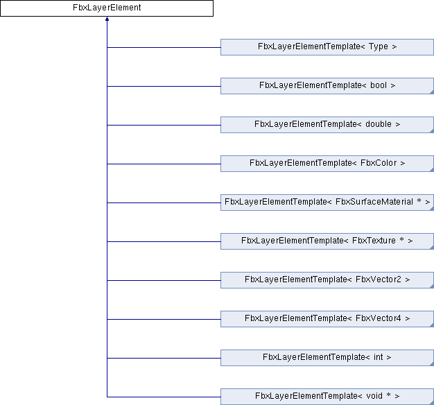

FbxLayerElement Class Reference
#include <fbxlayer.h>
Class Description
Base class for elements of layers (FbxLayer).
A layer element type is identified by EType. A FbxLayerElement describes how the layer element is mapped to a geometry surface and how the mapping information is arranged in memory. A FbxLayerElement contains Normals, UVs or other kind of information.
See also
FbxLayer
FbxLayerElement::EMappingMode
FbxLayerElement::EReferenceMode
Definition at line 38 of file fbxlayer.h.
+ Inheritance diagram for FbxLayerElement:
