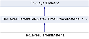

+ Inheritance diagram for FbxLayerElementMaterial:
Classes
class  LayerElementArrayProxy
Public Types
typedef FbxLayerElementTemplate< FbxSurfaceMaterial * > ParentClass
