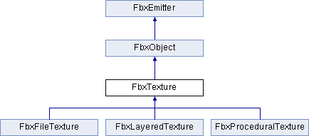

This class is the base class for textures, ie classes FbxFileTexture, FbxLayeredTexture and FbxProceduralTexture.
It describes image mapping on top of a geometry.
+ Examples:
Definition at line 26 of file fbxtexture.h.
+ Inheritance diagram for FbxTexture:
