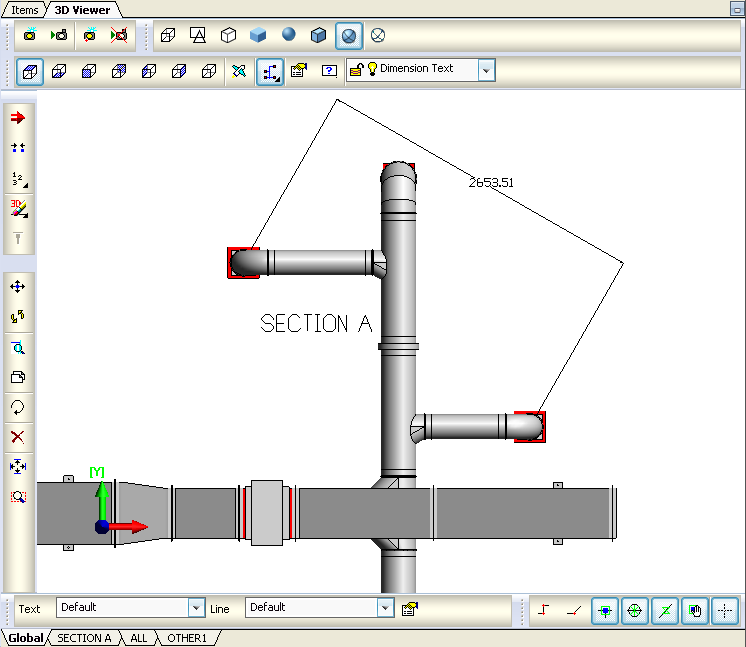

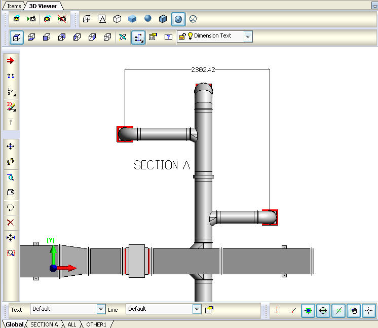

DIMALIGNED (DAL): Creates an alignment between two points. Selecting this option lets you manually select points that are required for measuring. Hovering over objects lets you snap to a desired point. You can then present dimensions on your tender drawing, which do not necessarily need to be parallel, as shown below.

DIMLINEAR (DLN): Creates a new linear dimension.
DIMORDINATE (DOR): Creates the dimensions, but in a parallel mode only, for straights, unlike the angled version, when using the DAL command.

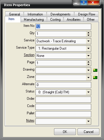

ITEMPROP (IP): Displays the Item Properties dialog (shown below) for selected objects.
Using this command to access a particular item and its properties is easier than searching for that specific item in Job Contents. Changes can be made using this Properties dialog.
