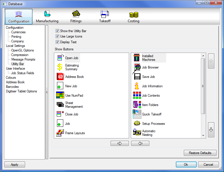

Docking, Displaying and Customizing
The Utility Bar can be dragged and placed anywhere on the screen, docked along any side of the application window, or hidden. You can also customize a variety of display options on the Utility Bar, such as selecting which icons are displayed or not, and displaying or not displaying the title text next to the button image. To customize the Utility Bar, right-click in the Utility Bar and select Customize. This displays the Database dialog, presenting a variety of options for customizing the Utility Bar.
