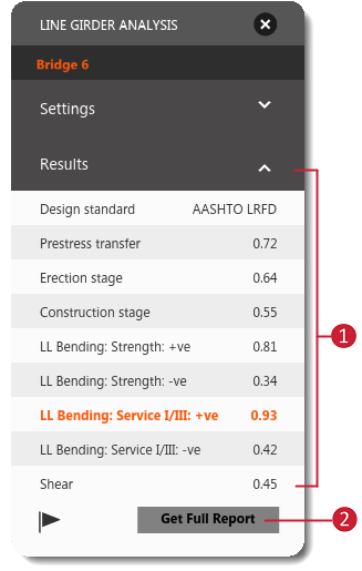

When you select a bridge in a model or proposal and start line girder analysis,
InfraWorks 360 will validate the initial rules-based layout of your bridge girders and compare your designs against bridge design standards that you can choose from, including AASHTO LRFD, British, Australian, and Eurocode.
- Key results can be viewed in-canvas. This does not require cloud credits.

- When you are ready, you can use your cloud credits to purchase full girder design documentation for the selected concrete bridge. When you select Get Full Report, InfraWorks 360 creates a new proposal in your model so that you can compare designs. Before you purchase the full report you can view or download a full-length sample in PDF format. See
