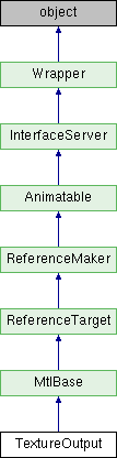

TextureOutput Class Reference
Used by texture maps to put up the 'Output' rollup in the materials editor, and perform the output filtering.
