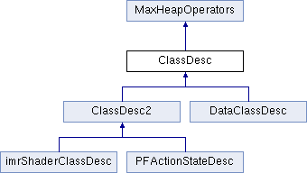

The developer creates a class descriptor by deriving a class from ClassDesc2 (which derives from ClassDesc) and implementing several of its methods.
+ Inheritance diagram for ClassDesc:
