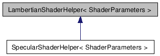

Inheritance diagram for LambertianShaderHelper< ShaderParameters >:
Inheritance graph
