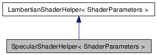

Inheritance diagram for SpecularShaderHelper< ShaderParameters >:
Inheritance graph
[legend]

Specular shader helper class.
This class extends LambertianShaderHelper to provide additional functionality for specular materials.
