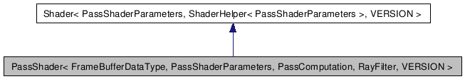

Inheritance diagram for PassShader< FrameBufferDataType, PassShaderParameters, PassComputation, RayFilter, VERSION >:
Inheritance graph
[legend]
