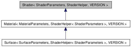

Inheritance diagram for Shader< ShaderParameters, ShaderHelper, VERSION >:
Inheritance graph
[legend]

The base shader class.
This class is the base shader class from which most of the Maya shaders are derived.
