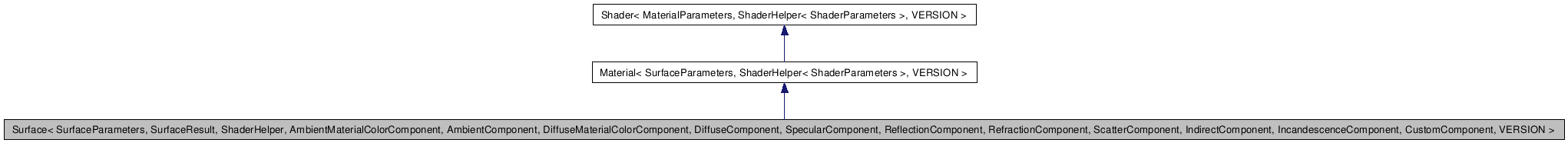

Inheritance diagram for Surface< SurfaceParameters, SurfaceResult, ShaderHelper, AmbientMaterialColorComponent, AmbientComponent, DiffuseMaterialColorComponent, DiffuseComponent, SpecularComponent, ReflectionComponent, RefractionComponent, ScatterComponent, IndirectComponent, IncandescenceComponent, CustomComponent, VERSION >:
Inheritance graph

Surface shader class.
This class holds all data and behaviors which are specific to mental ray surface shaders. It is an extention of the Material class.
