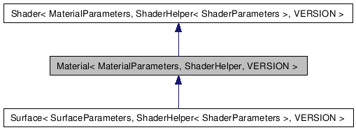

Inheritance diagram for Material< MaterialParameters, ShaderHelper, VERSION >:
Inheritance graph

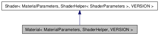

Collaboration diagram for Material< MaterialParameters, ShaderHelper, VERSION >:
Collaboration graph
