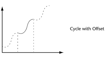

Cycle with Offset
The Cycle with Offset setting repeats the animation curve infinitely, except it appends the cycled curve’s last key’s value to the value of the first key’s original curve.

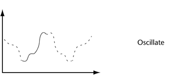

Oscillate
The Oscillate setting repeats the animation curve by reversing its values, and therefore shape, with each cycle, creating an alternating backwards and forwards effect.

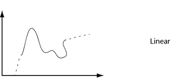

Linear
The Linear setting extrapolates the value of the first key using its tangent information. It projects a linear curve infinitely beyond.

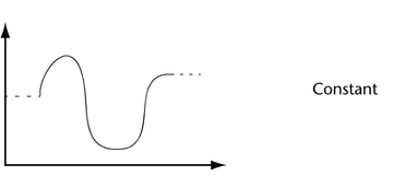

Constant
The Constant setting maintains the value of the end keys. This is the default setting for animation curves in Maya.

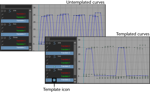

Template Channel
Templates the selected animation channel in the outliner and its corresponding animation curve in the graph view.
When an animation channel is templated, its keys continue to contribute to its object’s overall animation, but its curve and keys in the graph view are no longer selectable. Also, a small T icon appears beside the templated channel in the outliner, and the templated channel curve appears gray in the graph view.
Templating animation channels and their curves is useful when you have several overlapping animation curves with many keys, and you want to edit only one curve, but you need to be able to see all the other curves in the graph view.

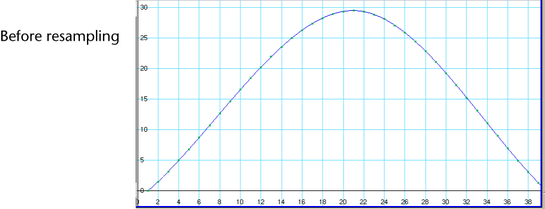

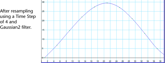

Resample Curve
Resampling creates a periodic frame rate by placing keys at uniform intervals.
To resample a curve, you select a sampling filter, which is an algorithm defining how the keys in the curve are resampled. Tangent and curve values are ignored. The filter converts animation curves with keys at either uniform or non-uniform intervals to curves with keys at a uniform interval that you specify.
Tip: The resampling filters are designed to reduce the number of keys in dense data curves. It may not produce the desired results when used on curves with few keys.

Resample Type
Specifies the resampling filter, which is an algorithm that defines how the keys in the curve are resampled. Choose one of the following:
Closest Sample
Uses the value of the sample that is closest to the nearest time step.
Linear Interpolation
Uses linear interpolation between two samples closest to the nearest time step.
Box Filter
Sums up all the samples in the filter area with an equal weight.
Triangle Filter
Uses a linear curve that affects the keys so that the least filtering happens at the edges of the sampled area.
Gaussian 2
Uses a sloped curve that weights the sampling gently at the top of the peak and toward the edge of the sampled area. This is the default.
Gaussian 4
Similar to the Gaussian2 filter but with a narrower base.
Time Step
Sets the period for resampling. If you set Time Step to 4, then a key frame will be placed every four frames. Resampling works best when the Time Step period is greater than the frequency of keyframes on the curve.
