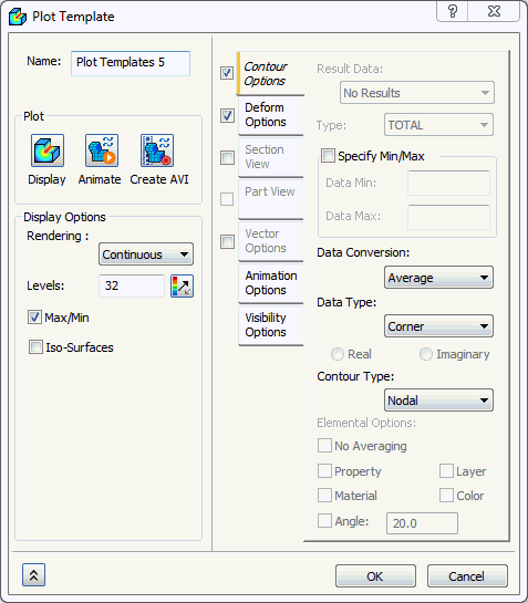

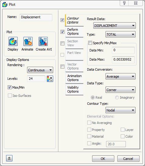

A typical Displacement plot template looks as shown in the figure below.
The form has the following main sections:
- Name: Enter a name for the template, for example, X- Displacements.
- If it is empty it takes the default result vector as the name of the plot.
- Plot: It has there buttons which are to plot the contour, animate and record an avi file.
- Display Options: It allows changing the rendering, levels and flipping the color bar using color flip button.
- Rendering: Various rendering options are available, like: Point, Line, Continuous, Fringe and Gouraud.
Levels:
- You can set the number of contour levels needed in this field which will adjust the plot and the contour levels accordingly.
- Maximum number of levels allowed is 252.
- Using
button it allows you to flip the color bar for easy visibility of contour.

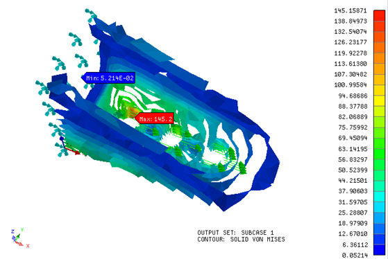

- Max/Min: This option, when checked, flags the nodes with the maximum and minimum values, displaying their corresponding values.
Iso-Surfaces:
- This option, when checked, displays surfaces with the same contour plot level.
- The number of surfaces depends on the number of levels set in the plot.
- The example in the figure below shows Iso-Surfaces with 12 levels on a contour plot of the part.

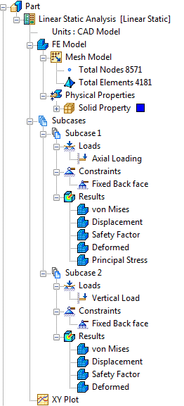

In the example shown in the figure below, the results loaded under 2 different subcases can be seen.
Notice that each set of results has four different plots loaded automatically.
- von Mises: It plots von Mises results with deformed plot.
- Displacement: It plots displacement results with deformed plot.
- Safety Factor: Plots factor of safety. Make sure to define the material allowables and failure theory in the material dialog.
- Deformed: Deformed model only (total displacements).
All the above plots use templates listed under Plot Templates at the bottom of the tree view with default post-processing display settings.
Each of these templates can be dragged and dropped into either a Subcase/Results or mode/increment under a Subcase/Results. Four of these templates are available; more can be created by right-clicking on Plot Templates and selecting New.
A new template looks as shown in the figure below (varies based on what boxes are checked).
