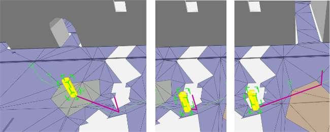

  • It can use a strategy based on straight-line shortcuts, computed by a ShortcutTrajectory object. The ShortcutTrajectory chooses a target point on the path that is both visible and a little ahead of the character's current position—by default, up to 10 meters ahead—and generates a velocity that heads toward that target point in a straight line. As it approaches the target point, it periodically updates the target to a new visible location farther along the path.
    For example, in the image below, while the Bot is approaching the corner, it continues to aim for the last visible point along the LivePath. When it gets close enough to the corner that it can see more of the LivePath, it advances its target point as far along the path as possible.
    This strategy provides a relatively simple and high-performance way for the character to skip past sharp turns in its initial path. However, it can allow the character to make abrupt changes in velocity and facing direction when a new shortcut becomes available.

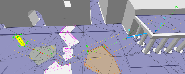

  • It can use a strategy based on channels and splines, computed by a SplineTrajectory object. This strategy is based on a channel: a representation of the navigable space around the initial path that is computed at the same time as the path. The SplineTrajectory examines the upcoming configuration of the channel's boundaries, and computes a spline that keeps the character's trajectory within those bounds.
    For example, in the image below, you can see the boundaries of the channel in orange. Note that the boundaries squeeze closer together in the narrow gap between the obstacles. Also note that there is no channel for the segment of the path that follows the NavGraph; the first channel ends at the start of the NavGraph edge, and a second channel begins on the rooftop. As with the shortcut example above, the Bot periodically computes a new spline (shown in red) as it progresses along the path.
    This strategy tends to produce more rounded trajectories that use a greater amount of the available space around the initial path, at the cost of slightly higher CPU usage during both the path finding phase (in order to generate the channel data) and the path following phase.
