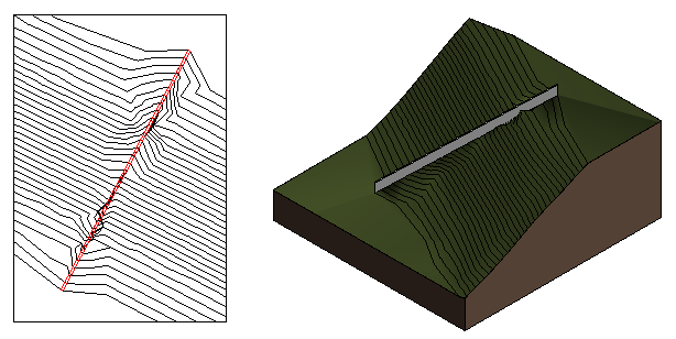

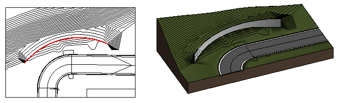

When creating a retaining wall,
Site Designer does the following:
- Calculates the elevation of the points on the host line.
- Places the wall.
- Projects cut slopes and fill slopes to tie from the top and back of the wall to the toposurface.
- Updates the proposed toposurface to reflect the wall and the new slopes.
