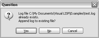

  3. Click Save to select the file you specified. If the file already exists, VLISP prompts you with the following message:
    If you reply Yes, VLISP appends new data to the current contents of the file. If you reply No, VLISP overwrites the file and its original contents will be lost. Click Cancel to terminate the operation and specify a different file name.
