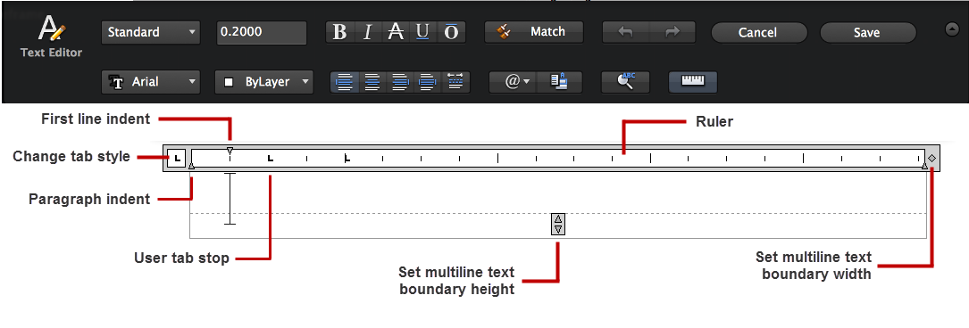

You can import or paste text from other files to use in multiline text, set tabs, adjust paragraph and line spacing and alignment, and create and modify columns.
The In-Place Text Editor includes
When a table cell is selected for editing, the In-Place Text Editor displays column letters and row numbers.
