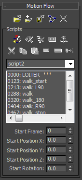

A script is a list of clips (BIP files) that control the character you are animating. To create a script, add clips to the Motion Flow Graph, then click Define Script in the Scripts section of the Motion Flow rollout, and click a sequence of clips in the Motion Flow Graph. Default transitions are assigned if no transitions exist between the clips. The clip names and starting frame numbers display in the list on the Motion Flow Script list.
A sample script as it appears in the Scripts group on the Motion Flow rollout
Random scripts vary the order of the clips found in the Motion Flow Graph. Scripts are run in a top-down order to animate the character. Click Play to view scripted motions on the biped.
Once a script is put together, you have additional controls that let you adjust the starting frame, the starting X, Y, or Z locations and the starting rotation of the animation.

Scripts group, click As you select the clips in the Motion Flow Graph dialog, they are added to the script list.
Adding a descriptive name is less confusing if you ever append Motion Flow Editor files together.
Now the biped will hold its start position until frame 25, then start moving.
These settings let you control the position of the footsteps that the character follows.
Often, the footsteps in a BIP file are not oriented in the direction you want. This setting lets you adjust which direction the character faces.
