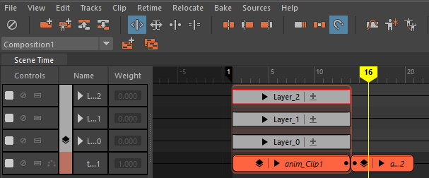

Time Editor Clip Layer highlighting
The actively-selected Clip Layer in the Time Editor is now drawn with a red outline to show that it is the layer currently selected as a keying target. This is useful when animating on a Time Editor clip with multiple layers.
The active clip layer is outlined in red
