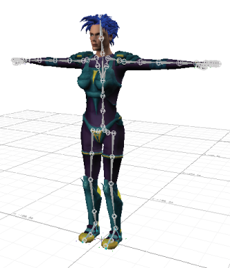

Before you can use the Definition tab to map the skeleton bones in your character to the nodes understood by the HIK solver, you must set up your character in a basic T-stance that provides HIK with crucial information about the proportions of the skeleton and joint transformations of your character.
The T-stance of your character must match the description and example given below as closely as possible in order for the inverse kinematics and retargeting solvers to produce accurate results for your character. Without a properly configured T-stance, the solvers will base all of their operations on faulty data, and will likely produce skewed, awkward or unexpected poses.
