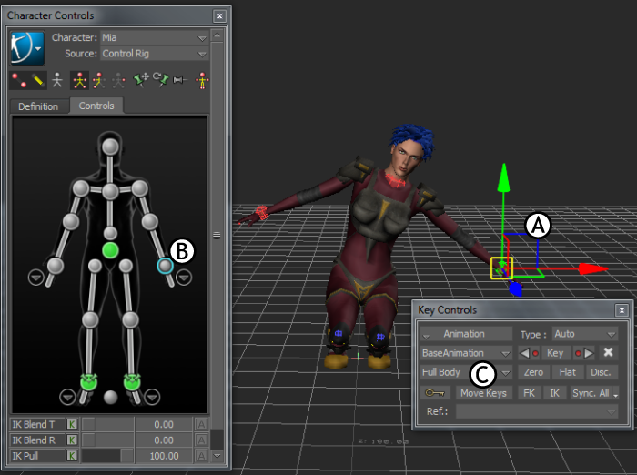

A. Entire body follows the IK system when manipulated B. Full Body mode is active in the Character Controls C. Full Body mode is also indicated in the Key Controls
The active Manipulation mode also determines what is keyed, so it is also displayed in the Key Controls window. When Full Body is selected in the Key Controls Keying Mode menu, it indicates that keyframes are set on the entire body of the character.
How your character reacts to manipulation when in Full Body mode depends on the pinning of various effectors, and whether Reach Override and Stiffness Override are active. See Pinning buttons and Edit menu options in the Character Controls window > Edit > Controls menu.
When in Full Body mode with Reach Override active, the Pull settings for your character are not shown during manipulation.

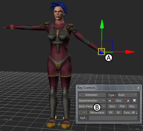

Body Part mode lets you use individual effectors to manipulate only the selected body part. The effectors on the rest of the body are not affected.
Body Part Keying mode is active A. Selecting the left wrist effector lets you translate all the effectors in the chain for the left arm B. The Key Controls window displays Body Parts
In Body Part mode, the keying mode in the Key Controls window is set to Body Part, and keyframes are set on the effectors that comprise the selected body part. For example, if you set keyframes with the left wrist effector selected in Body Part Keying mode, you set keyframes on the left wrist, left elbow, and left shoulder.

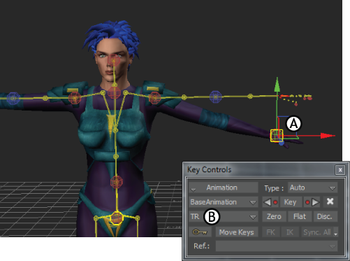

When Selection is active, you can manually select what you want to manipulate and keyframe on a character. As you manipulate your character, the Control rig does not synchronize and update in real time as it does in Full Body and Body Part modes.
Selection Keying mode is active A. Selecting the left wrist effector lets you independently manipulate that effector B. Keying Mode in the Key Controls displays the previous selection (in this case, TRS)
In Selection mode, the keying mode in the Key Controls corresponds to the previous selection. For example, if the translation, rotation, and scaling properties were previously selected, TRS displays in the Key Controls.

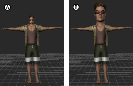

A. Head is normal size B. Only the head is scaled
