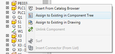

  1. Click Project tabProject Tools panelManager. Find
  2. In the Project Manager, click the Location View tab.
  3. In the Location View tab, right-click the Inventor part and click Assign to Existing in Component Tree.
    Note: You can also select an electrical component and assign it to an Inventor part. If you hover over any component that cannot be linked, you would see a 'stop' icon indicating that you cannot assign to that component in the tree.
  4. In the component tree view, select the electrical component you want to link with the Inventor part. The component tree view is automatically refreshed to show the linked component.
