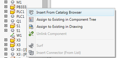

  3. In the Location View tab, right-click the unlinked Inventor part and select Insert from Catalog Browser .
