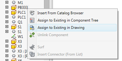

  1. Click Project tabProject Tools panelManager. Find
  2. In the Project Manager, click the Location View tab.
  3. In the Location View tab, right-click the Inventor part and click Assign to Existing in Drawing .
  4. In the active drawing, select the electrical component you want to link with the Inventor part. The component tree view is refreshed to show the linked component.
    Note: . Indicates the components are linked but there are differences. You can resolve the differences on the Details panel of the Location View tab.
