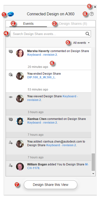

The Connected Design on A360 Panel gives you quick and convenient access to your Design Shares.
Access:
  In Inventor, click the Connected Design button
   located in the bottom right of the graphics window. The
  Events tab displays by default.
- A360:
	  launches your
	 A360 drive.
- Events tab
	  displays all Design Share events for all your Design Shares that you own and are a collaborator of. An event is any action performed by you or by your collaborators with whom you share Design Shares. Incoming and new events display with a white background.
	 Design Shares tab
		 is used to mange the Design Shares you own.
	 Search Design Share events
	  field searches through the entire library.
- All events provides access to filtering events*.
- Design Share event shows the type of event, time of the event. A Design Share event also provides access to the Design Share for viewing and posting comments*. New and incoming events display with a white background.
-  Design Share this View
	  launches the Start Design Share on A360 dialog box where you can create a Design Share from the present view of the open part or assembly file.
- Help
	  launches Help for working with Inventor Connected Design on A360.
- Close button closes the Connected Design on A360 Panel.
*Events tab only

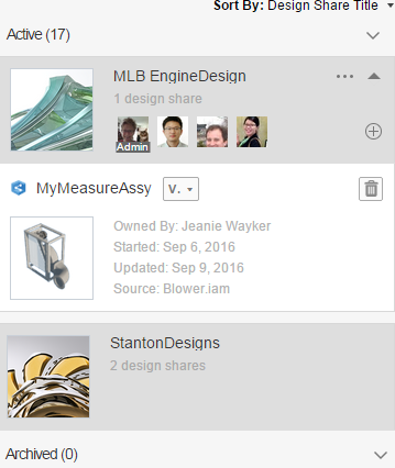

The
  Design Shares tab
   provides controls for owners for organizing and managing Design Shares.
- Sort feature for sorting Design Shares by Date Started, Design Share Title, Last Commented.
- Owned by me displays Design Shares you own and are active.
- Design Share
		management tools
		. The thumbnail provides access to the Design Share for viewing and posting comments.
- Shared with me displays Design Shares you have been invited to participate as a collaborator.
- Archived displays Design Shares no longer active.
