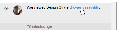

	  located in the bottom right of the graphics window. The Events tab displays by default. The most recent events display at the top. located in the bottom right of the graphics window. The Events tab displays by default. The most recent events display at the top.
-  Click on the name of the Design Share:
	 - Events tab: Click the blue text.

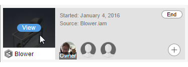

- Design Share tab:
		   Hover your mouse over the thumbnail, and click View.
 The Design Share opens in the viewing window inside Inventor (Inventor 2017) or a browser window (Inventor 2016R3).
