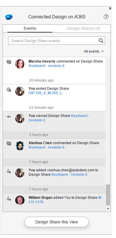

displays in a part or assembly file in the bottom right corner of the graphics window.

A Design Share is a 3D viewable read-only copy of the view of the 3D model that was open when you created the Design Share.
The Design Share is accessible from Inventor 2016 R3, Inventor 2017 and from the owner's and the collaborator's A360 drive. The SHARED WITH ME folder on the A360 web drive displays links to all Design Shares that are shared with you. The OWNED BY ME folder contains all the Design Shares that you own in a folder called Inventor Design Shares.
