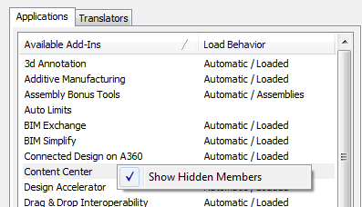

Connected Design on A360 functionality is not loaded by default when you open a part or assembly file. You must load the Inventor Connected Design add-in using the Add-in Manager. Once loaded, the Connected Design entry button
   displays in a part or assembly file in the bottom right corner of the graphics window.
In the Add-in Manager dialog box, double-click the name Connected Design on A360 in the list to switch between Loaded and Unloaded. Select Load Automatically to load the add-in automatically.

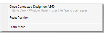

Right-click the Connected Design entry button and select Close Connected Design on A360.
To move the Design Share entry button, select the button with your mouse, and move to a location on the graphics window that works best for you.
To move the Design Shares button back to its default position, right-click the Connected Design entry button, and select Reset Position.
