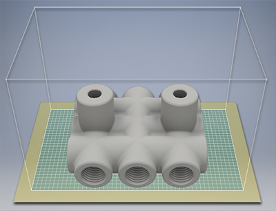

Select the printer and print options you want to use.

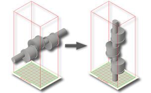

Rotate the model into position relative to the build space.

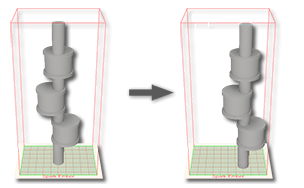

Position the model within the build space.

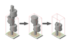

Partition components too large for the build space and place alignment features so the parts are easily assembled after printing.
Use modeling commands, such as direct edit, to adjust features according to the needs of the printer or process. You can control quantity and location of alignment features and their size parameters.
Explicitly edit an alignment feature by exploding the partition and editing the sub-features. The explode action is persistent.
