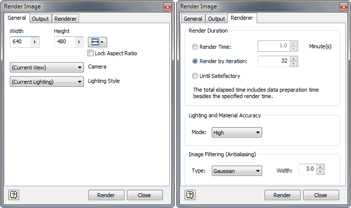

New support for Image Based Lighting (IBL)
All lighting styles in Inventor Studio are now associated with an IBL. IBL provides a better lighting source.
Image-based lighting from the modeling environment is now supported by Inventor Studio. To render from the modeling lighting environment, use the commands available on the View tab, then use the Current Lighting in the Studio Render Image dialog box, or change to other lighting styles from Render Image dialog box.

Advanced rendering engine RapidRT provides new configurations for rendering
Obsolete options removed:

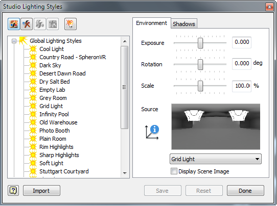

New IBL styles
11 new lighting styles are added to the View tab Appearance Panel Lighting Styles menu. These include Dark Sky, Gray Room, Infinity Pool, Photo Booth, Tranquility Blue, Sharp Highlights, Rim Highlights, Cool Light, Warm Light, Soft Light, and Grid Light.
