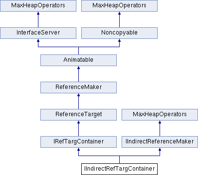

+ Inheritance diagram for IIndirectRefTargContainer:
