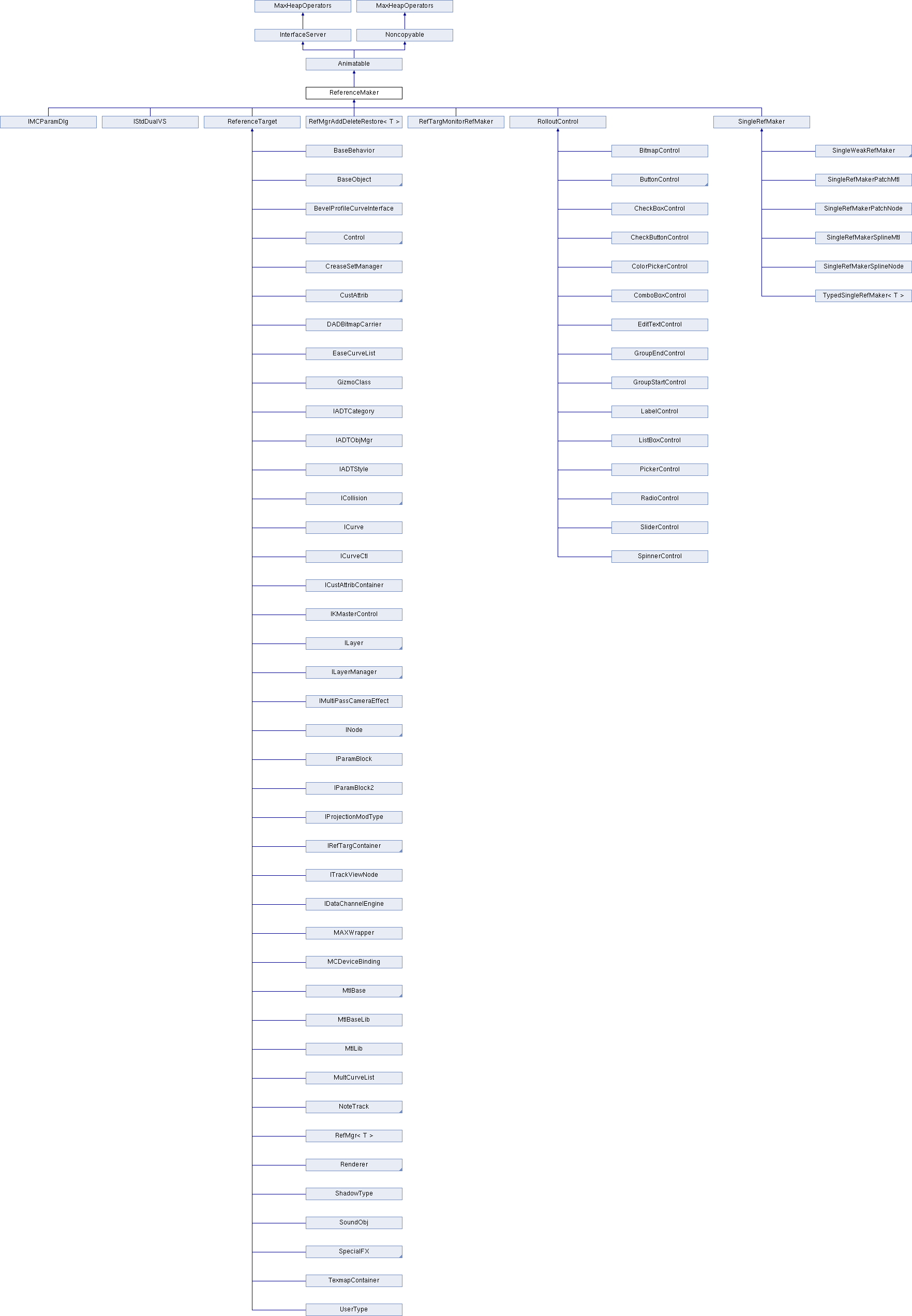

+ Inheritance diagram for ReferenceMaker:
